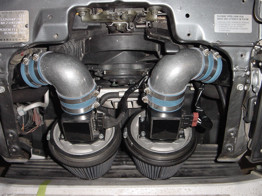

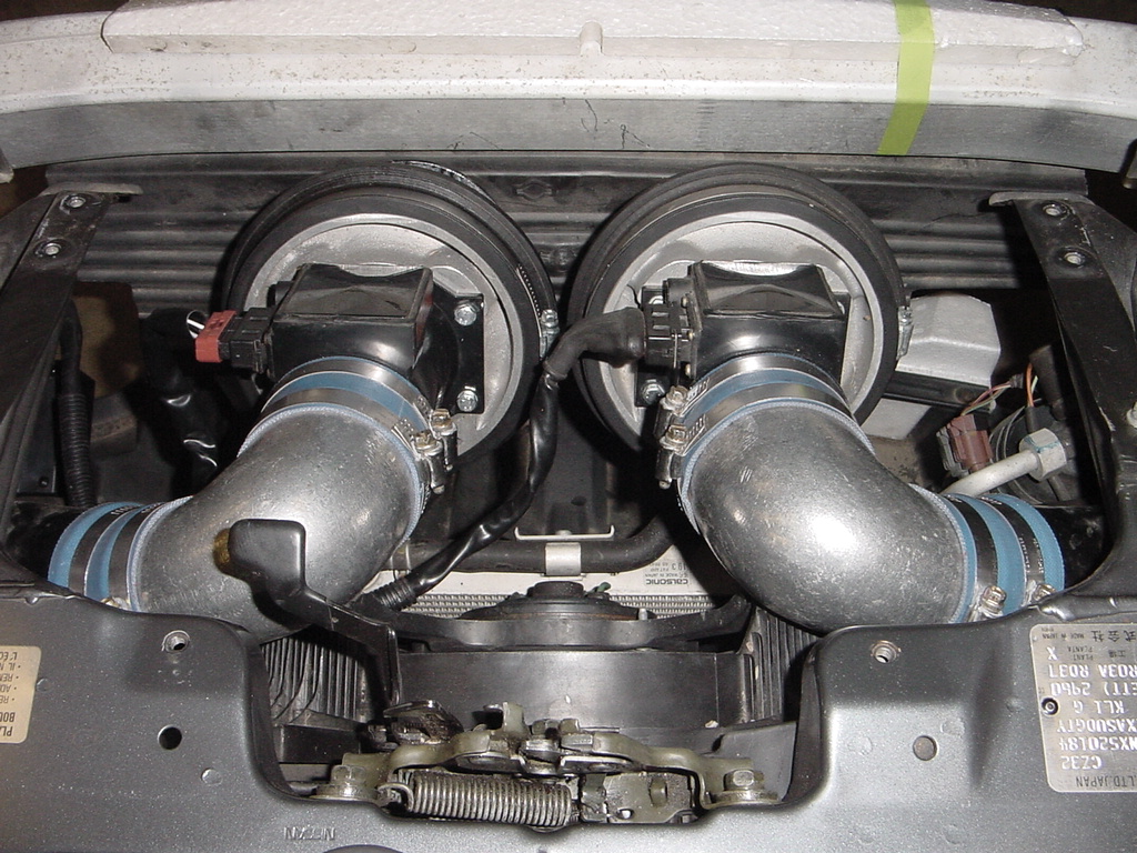

Message always made the most sense... 2 filters, 2 MAFs, 2 elbows.
From an install this past weekend...
Both MAFs are functional, feeding to a Apexi SAFC2, stock splash shield is in place and fully functional - they are not getting wind blasted - therefore no stalling or hesitation issues. Plenty of clearance for oil cooler & aux fan.
